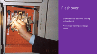

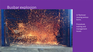

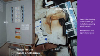

Electrical incidents
Here are some examples of incidents that could have been prevented if the company had had effective electrical safety management.
