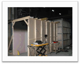

Stage one of the research was to design and construct a fire test room (ISO room), sized 3.6 m x 2.4 m x 2.4 m, with an attached timber-framed and plasterboard (single layer 12.5 mm Type F) lined corridor of dimensions 3.5 m x 1.5 m x 2.4 m (see Figure 1).  The walls, floor and ceiling of the ISO room were lined with two layers of 12.5 mm Type F plasterboard to contain the crib fire and, with the structure being on wheels, it was slightly raised from the ground; hence the corridor was not in line with the top of the ISO room (see Figures 1 and 2).
Figure 1. ISO room and attached corridor, showing timber sleepers and concrete lintels above corridor construction

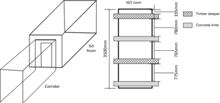

The test rig was then completed by positioning two timber sleepers and two concrete lintels above the corridor, spaced approximately 750 mm apart, and alternate to each other, to which the cables and supports were then secured.  For ease of reporting, BRE numbered the lintels from 1 to 4, where lintel 1 was closest to the ISO room, and therefore closest to the fires.
Figure 2. Real world set-up

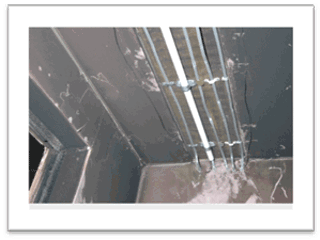

Figure 3. Close up of cable set fixed to timber sleeper with different supports
Cables and cable supports
In each experiment, five standard 1.5 mm2 flat twin and earth PVC sheathed cables were fixed to the lintels by means of commercially available ‘fit for purpose’ cable supports (see Figure 3), the detail of each is shown in Table 1 of this article.  However,  for ease of reference, four were of metal construction, with one type used to secure a cable oversleeved with a length 20 mm heavy gauge PVC conduit, and the fifth was moulded plastic cable clips.  To help simplify things going forward, wherever the term ‘support(s)’ is used, it refers to metal cable supports; ‘clip(s)’ refers to plastic cable clips; and ‘fixed’ or ‘fixing(s)’ refers to the means of securing the cable supports and clips to the structure.
All of the supports, except for clip 5 (as it was fixed using its own pin) were fixed to the lintels by means of zinc plated hardened steel 7 x 1¼ inch screws, but in the case of the concrete lintels, standard plastic wall plugs were also used.
