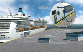

Shore power, also known as ‘cold ironing’, enables ships to turn off their electricity generators and connect to local electric power that is supplied to the ship from the utility at the dock. Cold ironing is a shipping industry term that first came into use when ships started to be fitted with steam engines and ancillary machinery. When a ship was tied up at port there was no need to continue to fire the boilers and the machinery would literally cool down, eventually going completely cold, which gives the term ‘cold ironing’.
In larger ships fitted with high voltage systems the shore-ship power connection requires a sophisticated system of transformers, frequency changers for 50/60 Hz connections, switchgear, special cables, circuit breakers and control systems. Smaller ships fitted with low voltage systems can ‘plug in’ to relatively simple shore supply outlets provided at sea ports, inland navigation ports and river wharfs. Shore-based electricity then runs all onboard services while the ship is secured on a shore berth.
Image credit: Image courtesy of ABB: http://www.abb.com/
