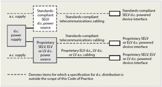

The Code of Practice sets out the requirements for the design, specification, selection, installation, commissioning, operation and maintenance of LV/ELV d.c. power distribution in buildings. It considers d.c. installations using telecommunications cabling, d.c. wiring or existing a.c. wiring infrastructure, including standardised solutions (such as PoE) as well as proprietary approaches for d.c. power distribution.
Figure 1: Schematic showing items within the scope of this Code of Practice (reused from the Code of Practice on Low and Extra Low Voltage Direct Current Power Distribution in Buildings
