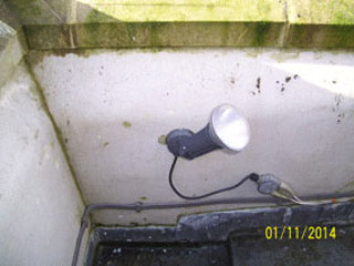

As an example, consider the lamp and its cabling on a church tower roof in the photograph below. At its closest point the cable has been routed neatly alongside the lightning ring conductor connecting the tower down conductors.
The formula for the simplified approach is:
s = (ki·kc·l) /km
where:
s = minimum separation required.
ki relates to the class of LPS, 0.04 for LPS classes III and IV, 0.06 for Class II and 0.08 for Class I. Here kj = 0.04 for a class IV LPS.
kc relates to the number of down conductors.
kc = 1 for n = 1, kc = 0.5 for n = 2 and kc = 0.44 for n ≥ 3 with a Type A earthing system, provided the earth resistances are reasonably equal, no more than 2:1, otherwise kc = 1. Here with 4 down conductors kc = 0.44
km relates to the insulation value of the separating material, air = 1, stone, bricks and concrete = 0.5. Here km = 0.5 as it is over stone which is not as good an insulator as air.
l is the down conductor length to the bonding point. Here l = 18 m.
As a result, the separation required is given by:
s = (0.04 x 0.44 x 18)/0.5 = 0.63 m
(IEC 62305-3 Protection against lightning Part 3 Physical damage to structures and life hazard - clause 6.3).

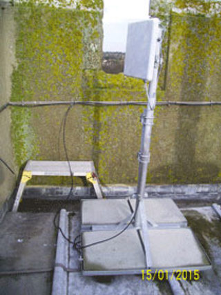

As another example, consider a church with a broadband relay on the roof of a church tower, as shown in the above photograph.
Features to notice in this installation are:
  • In the bottom left hand corner of the photograph the broadband supporting structure, correctly, is bonded to the lightning ring conductor around the inside of the parapet.
  • The antenna feed cable is lying on the lead covering of the tower roof. Although not shown in the photograph the lead, correctly, is bonded to the lightning conductors.
  • Across the middle of the photograph, the antenna feed cable has been routed along the lightning ring conductor.
During a lightning strike there would be a large voltage between the frame of the antenna and the antenna live feed. At present, the church has two down conductors, on opposite faces of the tower, with neither conductor bonded to the MET. The separation requirement is certainly not being met in this case. Although the requirement is difficult to meet for this installation, one solution is to fit a combined Type 1 and Type 2 SPD between the live feed and the shield (assuming that the shield is bonded to the frame). The SPD could be fitted at the amplifier, situated just inside the stair turret. It would still be good practice to separate the antenna feed from the lightning ring conductor by, for example, 250 mm.
