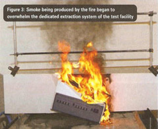

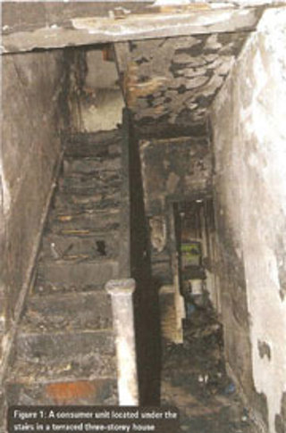

Regulation 421.1.201 was introduced because of reports from fire investigators of a recent trend of increasing numbers of fires involving consumer units having a moulded thermoplastic enclosure. See Figures 1, 2 and 3.
The cause of the fires investigated was almost invariably found to be resistance heating as a result of poor electrical connections due to poor workmanship or lack of maintenance.  Examples of such poor workmanship are thought to include:
  • failure to tighten neutral conductor connections to the same torque as line conductor connections due to a misconception that neutral conductors carry less current
  • inadvertently taking cable insulation inside the terminal at a connection, resulting in the securing screw or the clamp of the terminal not making proper contact with the conductor
  • failure to check factory-installed connections for tightness where required to do so by the manufacturer, and
  • tightening connections to an incorrect torque and/or with inappropriate tools.
The crucial importance of checking that all electrical connections are properly made, and of taking remedial action where necessary, should never be forgotten.
Whilst the main cause of fire within plastic consumer unit enclosures is without doubt poor workmanship, other potential causes of fire within plastic consumer unit enclosures are thought to include:
  • the type of internal components, such as where terminations have only one securing screw or are of the 'cage clamp' type), and
  • where increased heat transfer to the enclosure is caused by the close proximity to an internal item, such as a neutral bar or a conductor terminated at the neutral bar and protruding above it.

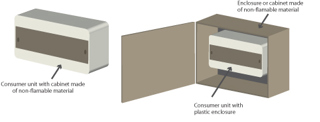

Regulation 421.1.201 gives the choice of either using a consumer unit (or similar switchgear assembly) having an enclosure manufactured from non-combustible material or using a consumer unit having an enclosure made from some other material, such as plastic, and installing it in a cabinet or enclosure constructed of non-combustible material.  See Figures 4(a) and 4(b).  In either case, certain requirements need to be met by the enclosure or cabinet, as explained below.
Figure 4 – The two ways to comply with enclosure requirements of Regulation 421.1.201
There is no published definition for the term ‘non combustible’ that aligns with the intent of Regulation 421.1.201. However, as stated in Note 1 to the regulation, ferrous metal, such as steel, is deemed to be an example of a non-combustible material.
Steel will no doubt be the material usually employed in the manufacture of the enclosure or cabinet.  Nevertheless, it will be open to manufacturers to offer enclosures or cabinets made from other types of material that they claim to be non-combustible within the intent of Regulation 421.1.201.  In this case, however, the manufacturer would have to provide suitable evidence to support the claim of non-combustibility, and it is not presently clear what criteria would be used to judge the non-combustibility of a material other than non-ferrous metal.

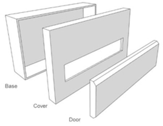

The non-combustible enclosure or cabinet must provide a complete envelope (for example, base, cover, door and any components such as hinges, screws and catches) as necessary to maintain fire containment. All blanks, circuit-breakers and other devices must be contained within the non-combustible enclosure or cabinet. Figure 5 shows an example.
Figure 5 – Example of non-combustible enclosure for consumer unit
Image credit: Image reprinted with kind permission from Hager

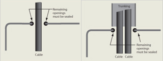

It is important for the installer to seal all openings into the enclosure or cabinet for cables, conduits, trunking or ducting that remain after the installation of cables - see Figure 6. The intent of the sealing is to ensure that, as far as is reasonably practicable, any fire is contained within the enclosure or cabinet and the escape of flames to the surroundings of the cabinet or enclosure or into conduits trunking or ducting is minimised, as intended by Regulation 421.1.201.
Good workmanship and proper materials must be used, and account must be taken of the manufacturer’s relevant instructions if any.
Figure 6 – Sealing of wiring entries
