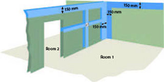

As at present, the revised requirements apply to cables at a concealed depth of less than 50 mm from the surface of a wall or partition and, irrespective of depth, if the cable is in a partition constructed of metallic parts other than fixings (such as nails or screws).
There is still an exception for cables forming part of a SELV or PELV circuit.
Cables must still be installed within the ‘safe’ zones illustrated in Figure 1, except where they have one of the other permitted methods of protection mentioned above, or they form part of a SELV or PELV circuit.
Figure 1 – Zone prescribed in Regulation Group 522.6
