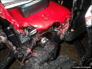

Can’t find your charger under a mountain of Christmas morning wrapping paper? Don’t be tempted to use the wrong charger in new electrical gadgets. Earlier this year a family had a lucky escape when they used the wrong charger in a toy car left to charge overnight. An adult and child were sleeping at the time and thankfully a smoke alarm gave them an early warning and they were able to escape the fire unharmed.
Devastation caused by using the wrong charger on a toy car
