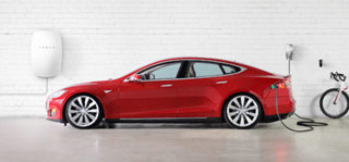

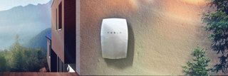

The Tesla storage device is lithium ion battery based and Tesla draw on their electric car experience to package a unit to smooth out power from PV installations. Many advance orders have been placed though we will probably not see the first units in the UK until 2016.
The Tesla energy storage unit is wall mounted.
Shown here for perspective in size, dimensions are 1300 mm x 860 mm x 180 mm
