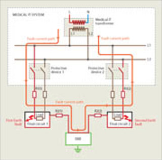

This has always caused an element of confusion as, technically, with an isolated system there is no Zs. However, in a healthy circuit, considering the following scenario, the term Zs is applicable even if it’s not in the usual context.
We can therefore see that there is an earth fault loop that is comprised of the impedance of:
(a)  the secondary winding (which effectively would be Ze);
(b)  L1 to the point of fault (which would be R1(1) in the diagram);
(c)  L2 to the point of fault (which would be R1(2)in the diagram); and
(d)  the earth path in the diagram, which would be between the points of fault and, in a Group 2 medical location, would be through the protective conductors and the supplementary bonding conductor for that location.
Relating the values back to the standard formula as above, we would find that:
      Zs = Ze +(R1+R2)
where:
Ze     is the impedance of the transformer secondary.
LOR  is the length of run of the cable in metres (m)
R1 = (R1(1) x LOR) +(R1(2) x LOR)Ω
R2= (R2(1) x LOR) +(R2(2) x LOR)Ω

Using the 20 A type B results:
      Zs= 1.0925 = Ze + (R1+R2)
Resulting in (R1+R2) = 1.0925-0.158= 0.9345 Ω
If the maximum impedance for any exposed or extraneous conductive part to the equipotential bonding busbar (EBB) is 0.1 Ω (set out by previous guidance) then the R2 maximum value would be 0.2 Ω.
Applying this to the formula:
R1 = 0.9345-0.2 = 0.7345 Ω
As the formula in Regulation 411.6.4 uses the factor 2 x Ia the formula takes into account that there are two circuits involved. The R1 impedance divided by the length of run (LOR) will therefore provide the theoretical maximum cable length (subject to volt drop and energy let-through limitations).
Using the 70 °C copper cable values from IET Guidance Note 1 we can see the following values for  Ohms per metre of cable at a particular size:
2.5 mm = 0.0889 Ω/m, 4 mm=0.0553 Ω/m, 6 mm = 0.037 Ω/m
Consequently, if R1 =using a 4.0 mm2 cable, this would give a maximum theoretical length (subject to capacitive coupling, volt drop and energy let through limitations) of:
Max LOR = 0.7345/0.00553 = 132.8 m
