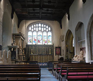

Example: St John’s Church, Cirencester. (Lighting design by Lighting Design & Technology)
The Catharine chapel has slim LED lighting strips concealed on ledges high up on each side to provide soft uplighting of the magnificent fan vaulting. The spotlights are mounted on brackets that are fixed over the ledge so that no fixing damages the historic main wall. The spotlights provide emphasis on to the altar and provides lighting for both the seating area and for the areas of revealed wall paintings. The wiring is run along the high-level ledges to conceal them from view and each spotlight or LED strip can be separately dimmed via a DALI control system, so that the balance of uplight to downlight or from altar to seating area can be changed to suit the use of the space.
The spotlights in the Lady Chapel are concealed behind the wooden down-stands from the ceiling so that they cannot be seen from most positions in the pews. As well as lighting the pews and altar area, additional spotlights with specific beam angles give emphasis to the monuments at the side of the space and to certain carved features on the wooden ceiling. These can be individually dimmed down via the control system.
