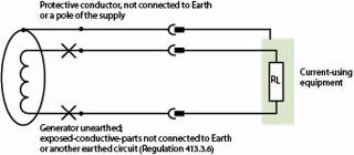

Electrical separation for the supply to one item of current-using equipment
Shock protection, via electrical separation, for a supply to one item of current using equipment, is provided when fault protection utilizes simple separation of the circuit from the main circuit and all of its associated circuits and Earth. Basic protection is provided by insulation or barriers.
When the basic protection fails in this type of installation the fault protection is afforded by simple separation from the main circuit because it has no fault path to Earth and therefore no electric shock. The downside of this is that with the loss of basic protection the fault is generally not cleared and goes undetected until there is a second fault, which may prove to be hazardous.
A generator commonly utilizes this type of simple separation, which is isolated from the main installation and not connected to Earth or any other earthed circuit. It is vital when using this type of protection method not to allow any exposed conductive parts of the equipment to be connected to the protective conductor or exposed conductive parts of other circuits. Another very common example of this type of protection is a shaver socket. See below for diagram of a generator supplying one item of current using equipment:
Diagram of a generator supplying one item of current using equipment
Electrical separation may be used for more than one item of current using equipment; however, the risks associated with this are greatly increased. Extra measures are required to ensure that the installation is safe. These measures include the requirement of the installation to be under the supervision of skilled or instructed persons in order to ensure that no changes are made that could lead to a dangerous scenario. Warning notices must also be present to control the connection of protective bonding conductors as these must not be connected to Earth.

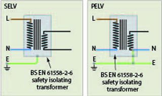

Extra-low voltage (SELV and PELV)
Shock protection by separated extra low voltage (SELV) and protected extra low voltage (PELV) are the same. This is arguably the safest measure as there are three protective provisions in play:
  • the limitation of voltage (limited to a voltage not exceeding 50V a.c or 120V ripple free d.c);
  • the protective separation; and
  • basic insulation.
By its definition SELV is electrically separated from Earth and so a single fault cannot result in an electric shock.
Protection from contact with normally live parts is provided by basic protection in the form of enclosures, barriers or basic insulation. If the nominal voltage of a SELV system or device does not exceed 25Va.c or 60Vd.c, protection from contact with normally live parts is negligible and may depend on the design use of the equipment. For example, some SELV lighting track systems will have the track section live, whilst in use, allowing the user to move the luminaires freely along the length of the track. The touch voltage in this case is not considered to be hazardous in general use.
SELV and PELV supplies are those supplies that are specified as safety isolating transformers in BS EN 61558-2-6. They are almost identical – in so much as both have a primary and secondary winding. The main difference is that the SELV transformer has no connection between Earth and its secondary winding whereas the PELV transformer has a connection to Earth from the secondary winding. Examples of these types of supplies are shown below:
It is for this reason that where a PELV transformer is used and the nominal voltage does not exceed 25V a.c or 60V d.c, in a normally dry location, the exposed conductive parts must be connected by a protective conductor to the main earthing terminal for the installation, where protection against contact with live parts may be omitted.
Fault protection in a PELV system is provided by the primary circuit protection, given the secondary winding’s connection to the installation earth terminal. One downfall of a PELV system is that faults elsewhere in the installation are likely to induce voltages on the PELV system through its protective conductor.
The downside of a SELV system is that it must be totally separated from any LV circuits as it does not utilise any protective conductors. To this end, the overcurrent protection in an unearthed SELV system dictates that, where required, devices are present in both live conductors. The need to ensure total separation in a SELV system and the lack of protective conductors requires the use of socket outlets that are not interchangeable with LV or other ELV systems present in the same property. This will further reduce any likelihood that a connection to Earth can be made in error.
