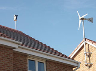

There are a wide range of micro-generation technologies, including solar photovoltaic (PV), wind turbines, small-scale hydro, and micro combined heat and power (CHP).

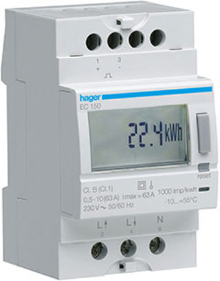

Metering: the smart electrical installation
Metering is an essential part of the SEI. In the individual SEI, meters and sensors measure and detect energy flow. Metering is provided to measure energy supplied both from the grid and supplied back to the grid (for example, where the installation includes PV panels or a wind turbine). Electricity generated on site by the installations’ own micro generation technologies is also metered and energy supplied from storage units such as batteries is metered. In addition, metering is provided to measure energy that is consumed by the various loads, such as motors, heating, lighting etc. The collective and shared SEIs include a wide range of meters and sensors to monitor and control energy.
